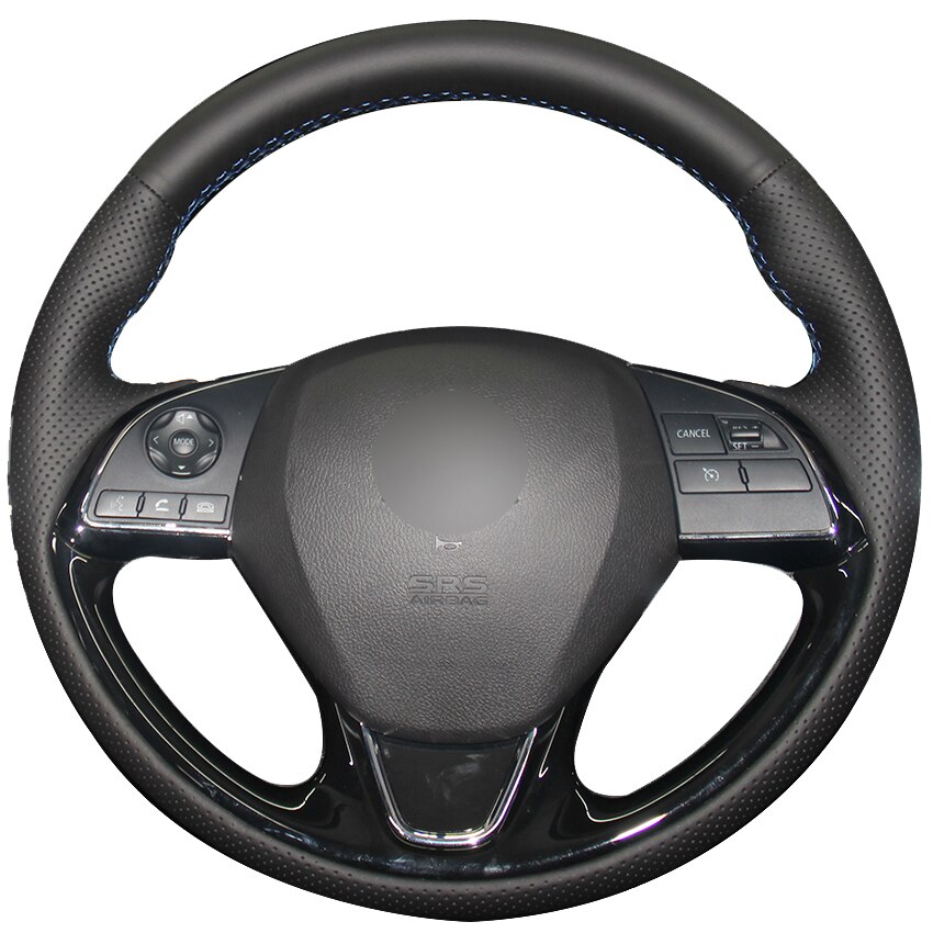

This is the Mitsubishi Triton steering wheel I want.
A mate of mine bought his a few weeks ago .
Sadly he won't let me pull it to bits to do a test fit
