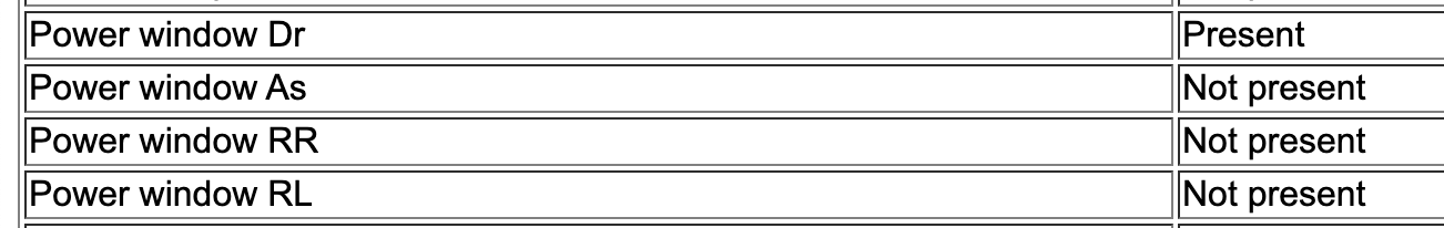

Re: Auto-up Windows
I think after reading somewhere you can't just change the Etacs to make it all the windows auto up. You have to chnage the window switch and install different motors that allow you to change the etacs settings.
Drivers window is set to present as standard if it has all the bits to make it work. My wife's 2008 my09 VRX doesnt have auto up on drivers window. I tried enabling it to present and it didnt do anything, it changed back to not present. I looked into this years ago and it was way to costly to make the drivers window go up after buying new switches and window motor. My Evo X does have auto up drivers window and is set to present in the etacs. There is another setting also I just cant find what its called after some google searching. You have to also change the power window types also and there is 3 or 4 settings. I have downloaded a trial of the driver to allow Mut-3 SE Software to work with my Tactrix I'll install and get some screen shots from both cars to show the different settings.
