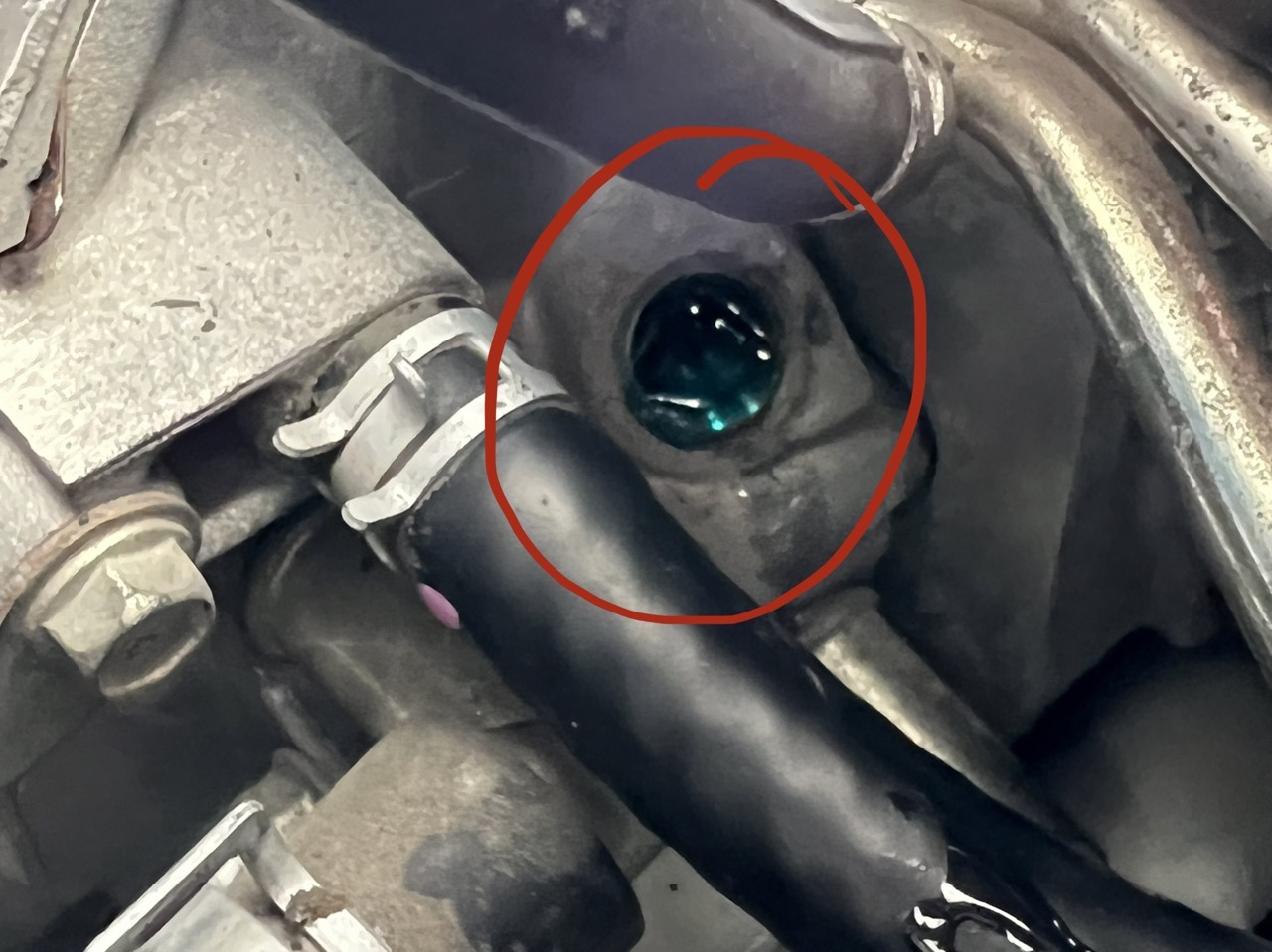

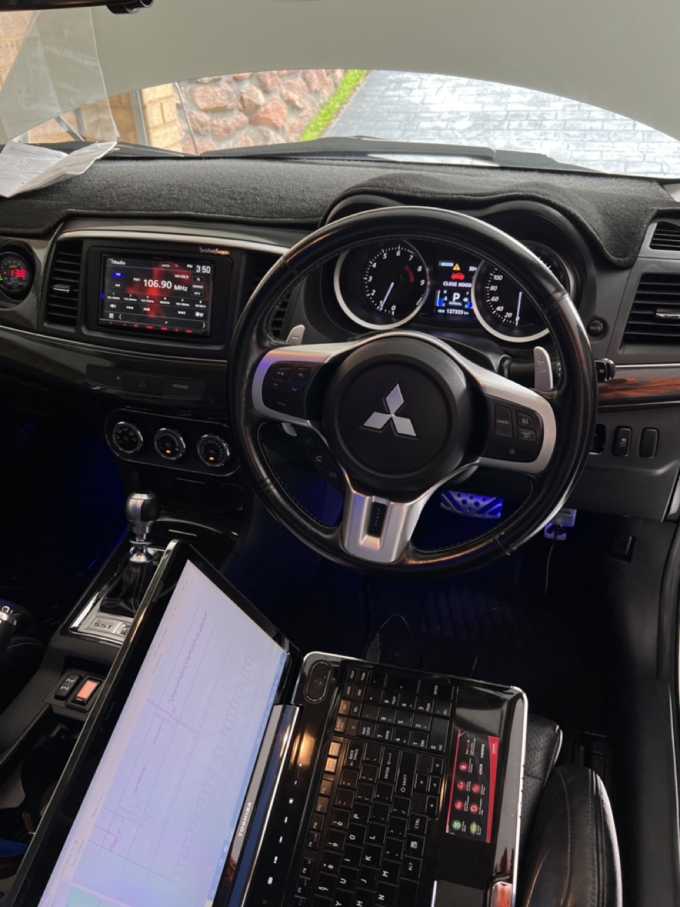

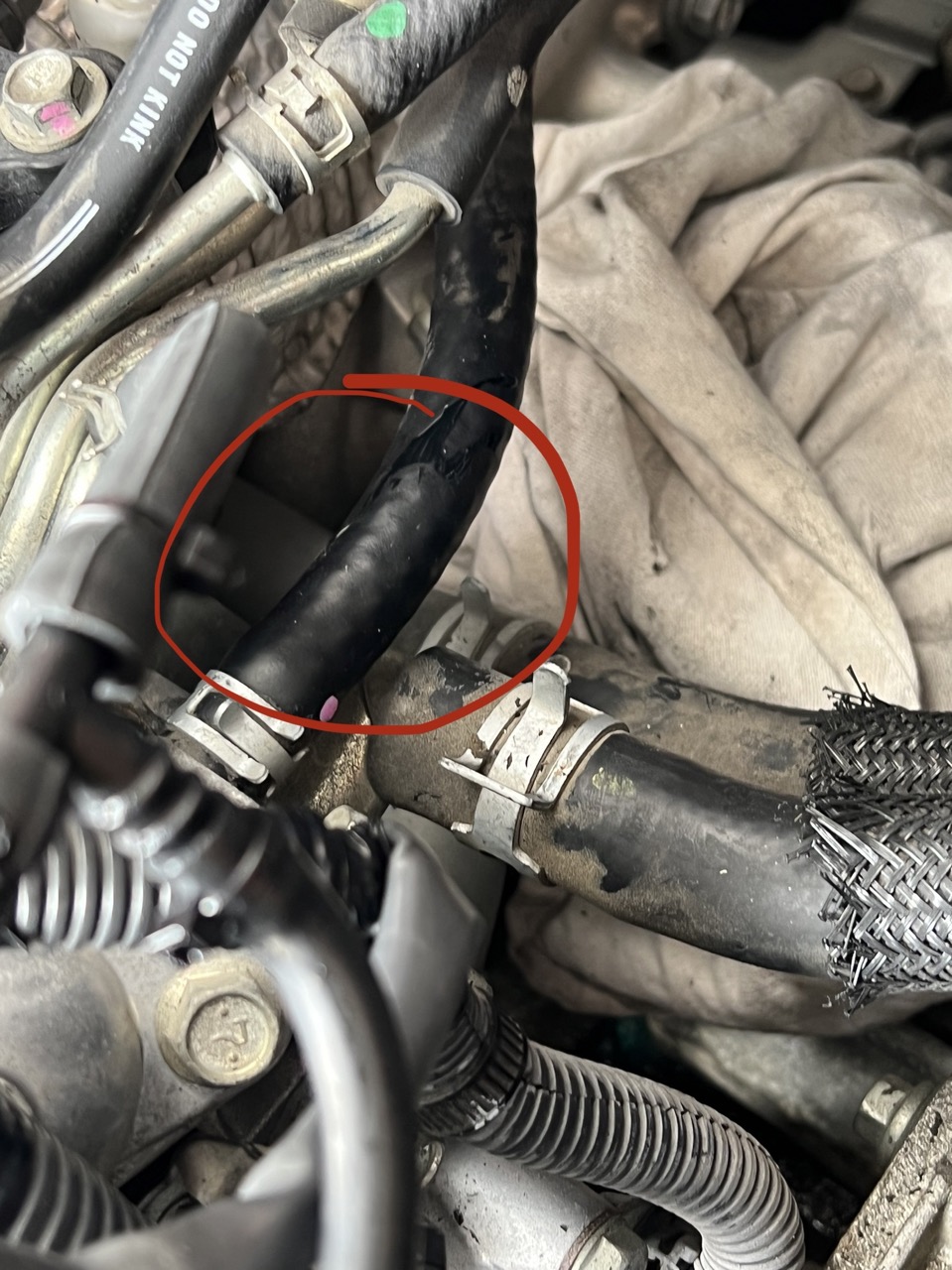

Ok, update on the car, it's all fixed now. I ended up ordering some Loctite 567 thread sealer. I was told its equivalent part is the Permatex stuff. To get the sensor out wasn't too much of a pain. I had them take out the rear fuel line bracket to allow a little bit of movement to get an extended 19mm socket in there. Thanks, @lancerdarryl for the advice about the coolant loss. I had it in the garage and fairly level. I had no coolant loss at all. Plugged in laptop cleared the code and gauge works again. I am off to get a new bung welded into the exhaust the old one stripped out when I attempted to remove it. So once that is done, I'll post up some pictures of the gauges all working.
