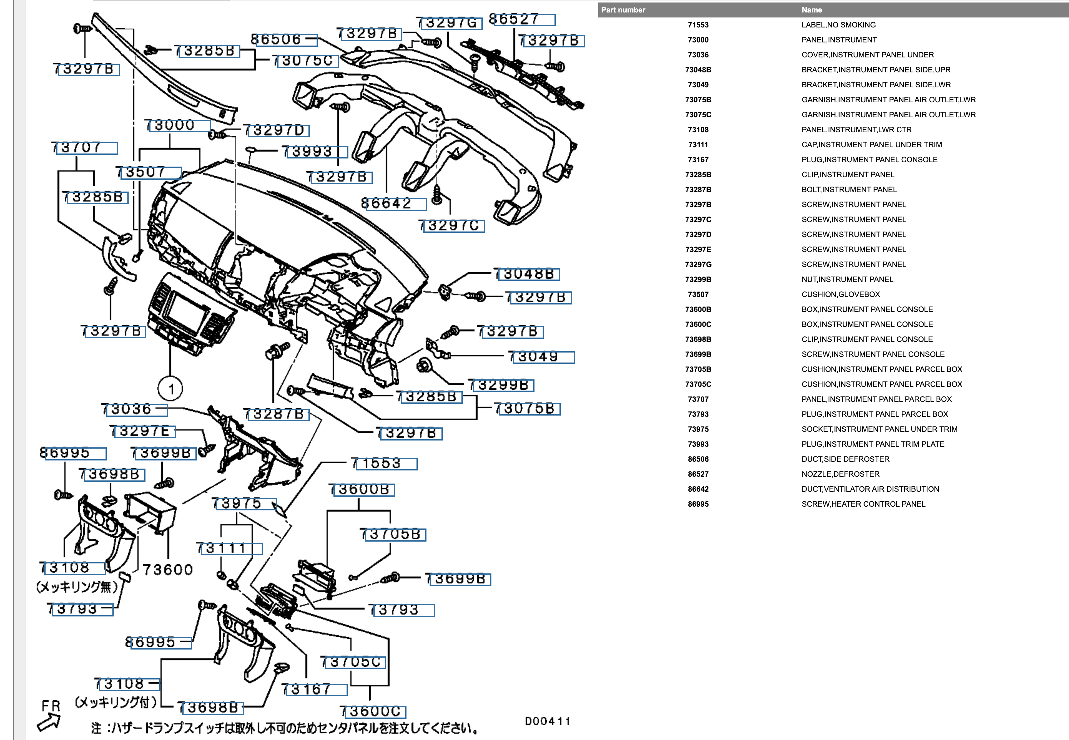

Here is a diagram best I could find. hopefully, it shows enough detail for you.
Screen Shot 2021-06-15 at 6.51.32 pm.png (918.43 KiB) Viewed 34589 times

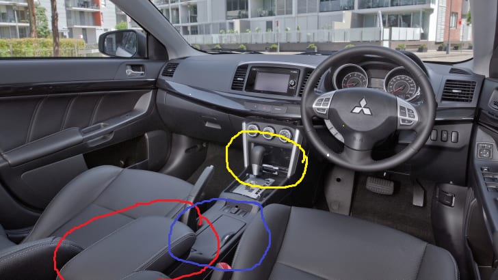

See the arm rest and the cup holder.

What colour part is it?

I believe Tywhiteguy is after the yellow part; the little bin forward of the shifter.
On the base lancers they were just a shallow in the plastic, on higher trims they had clicky doors.

My particular motor vehicle only has the one door in that position that flips up.
It covers the 12v power outlet and the phone charger plug leaving a small space to the right.
