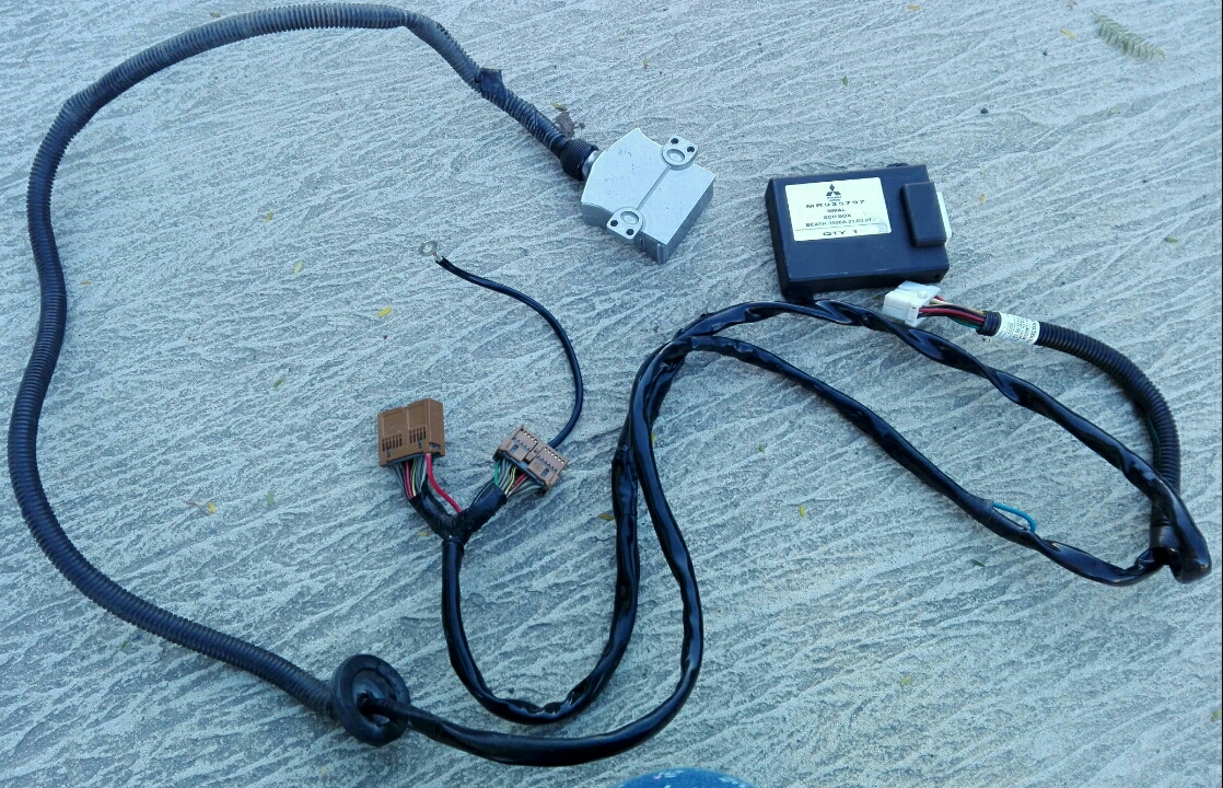

Can you show us a photo of the ALL the parts you have for the wiring harness?

This is all the wiring I've been given. The white plug fits in the ECU so I assumed I was looking for a plug in the car that fits the brown plugs. I have followed the wiring all the way back to the dashboard. The only place I haven't looked in under the passenger seat as it seems some wires go off that direction under the carpet but I was hoping not to have to remove the front passenger seat.
Re: Tow bar wiring
Postby lancerdarryl » Thu Jul 20, 2017 5:09 pm
Looks like you have everything but the wire and fuse holder that plugs into the battery.The brown plug should be in the LHR guard area. I'll see what I can track down for you and get back to you on Friday :)

Turns out the kit they sent me only fits up to 2011 model, not 2012 (as it was advertised!). So, this explains why it has been such a head wreck to install. Thanks for everyone's help. Hopefully the correct part will be easier to install

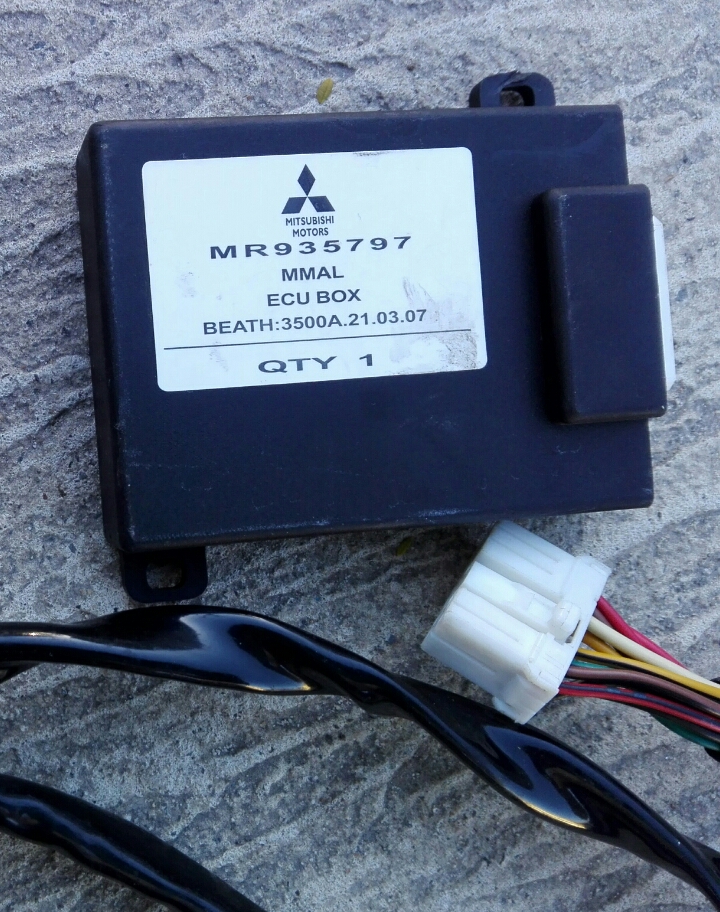

Postby dopey » Mon Jul 09, 2018 5:16 pm
hey all, does anyone know if the actual tow bar is the same between sedans and hatches? I know the kits have different part numbers, but there is a hatch at the wreckers with a tow bar with a part number MR936608 which looks like it will bolt up to a sedan.
Also what does the front wiring do, the bit in the engine bay on page 14 of the install instructions above? I checked out the engine bay but couldn't find it, though it had the genuine wiring loom in the back with the ECU MR935797.
Thank you!
