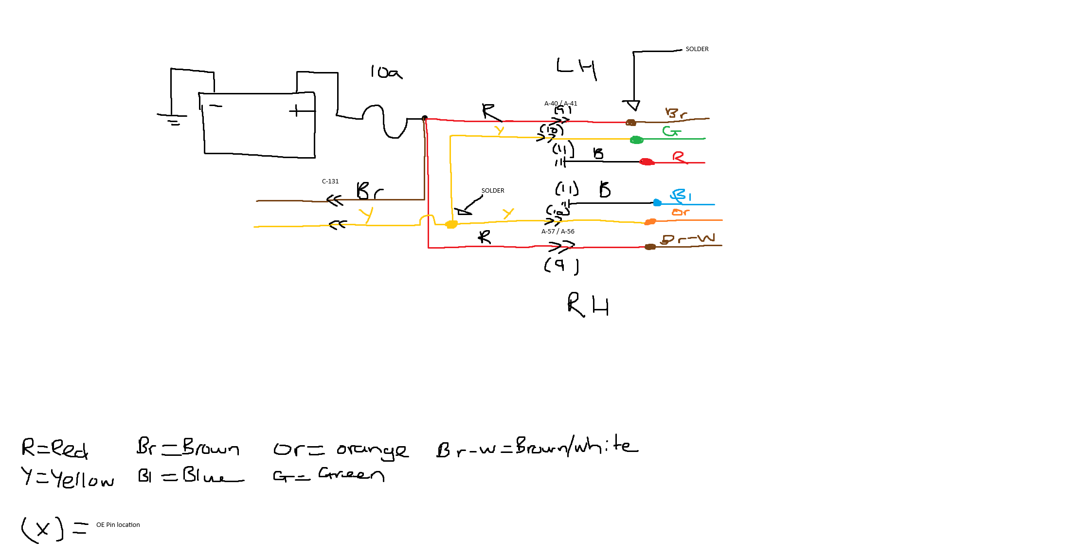

I've attached a VERY MESSY MS paint wiring diagram
wire layout messy.png (46.24 KiB) Viewed 18561 times
