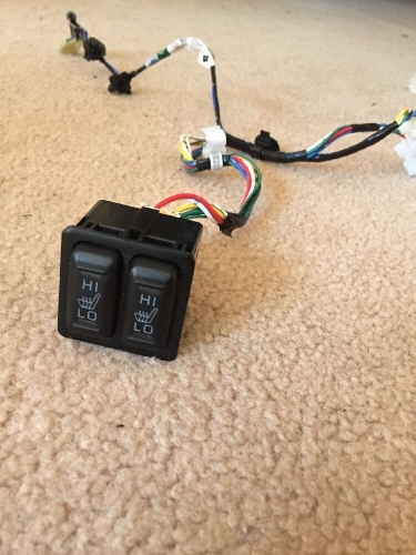

I managed to snatch a switch and wiring harness from eBay for about $100 and did a DIY install today. This is what I got:
464571fc-d6d9-4634-b403-f07ac151a188_zpsppaeguey.JPG.21f3610fccc97b319f76acb1f0a46b49.jpeg
Heated Seats Switch and Harness
464571fc-d6d9-4634-b403-f07ac151a188_zpsppaeguey.JPG.21f3610fccc97b319f76acb1f0a46b49.jpeg (151.91 KiB) Viewed 11507 times

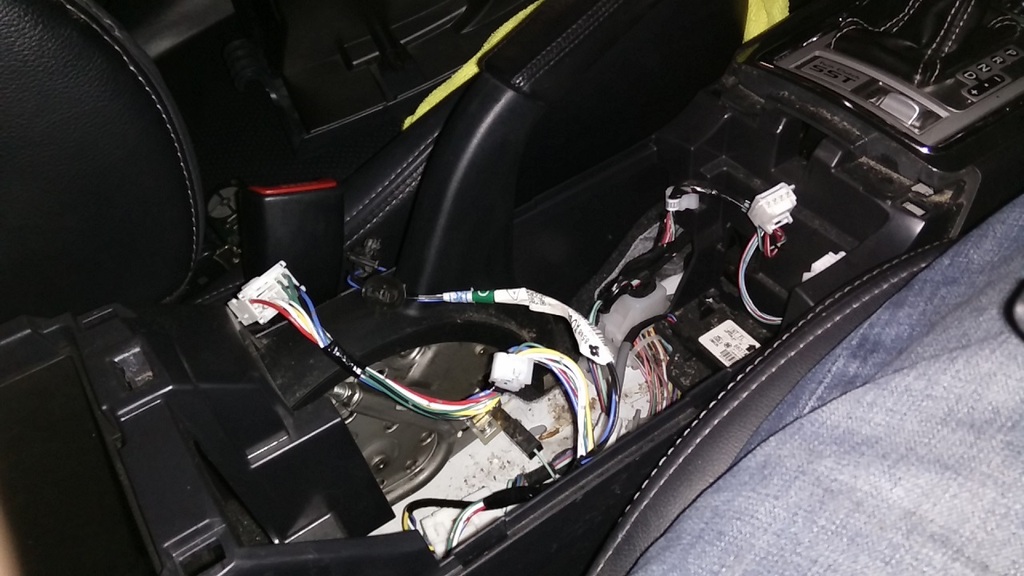

I didn't have the relay with me, so I temporarily used the defroster relay for this until I get the relay from a wrecker this week. The harness came with the connector to the 12v socket that sits in the compartment under the arm rest. And I had to remove and take out the entire centre console just to plug in the new harness to the 12v socket.
Anyway, after a couple of hours of work, I managed to get them to work. It was pretty easy.
This is the under side of the centre console, the new harness connected to the 12v socket and secured to the console using the plastic mounting clips.
Heated Seats Wiring Under Console

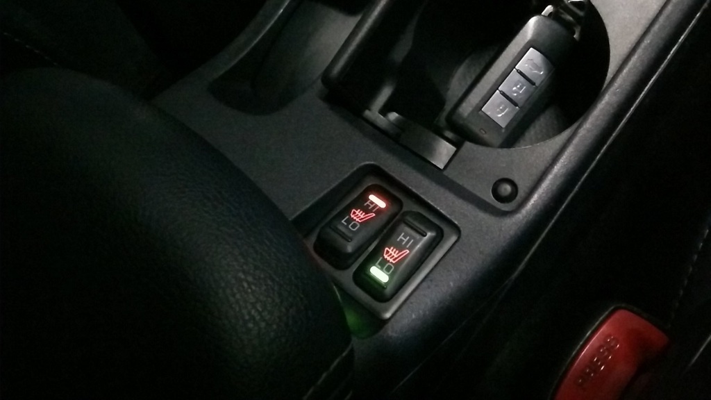

All done! :)
CJ Lancer Heated Seats
