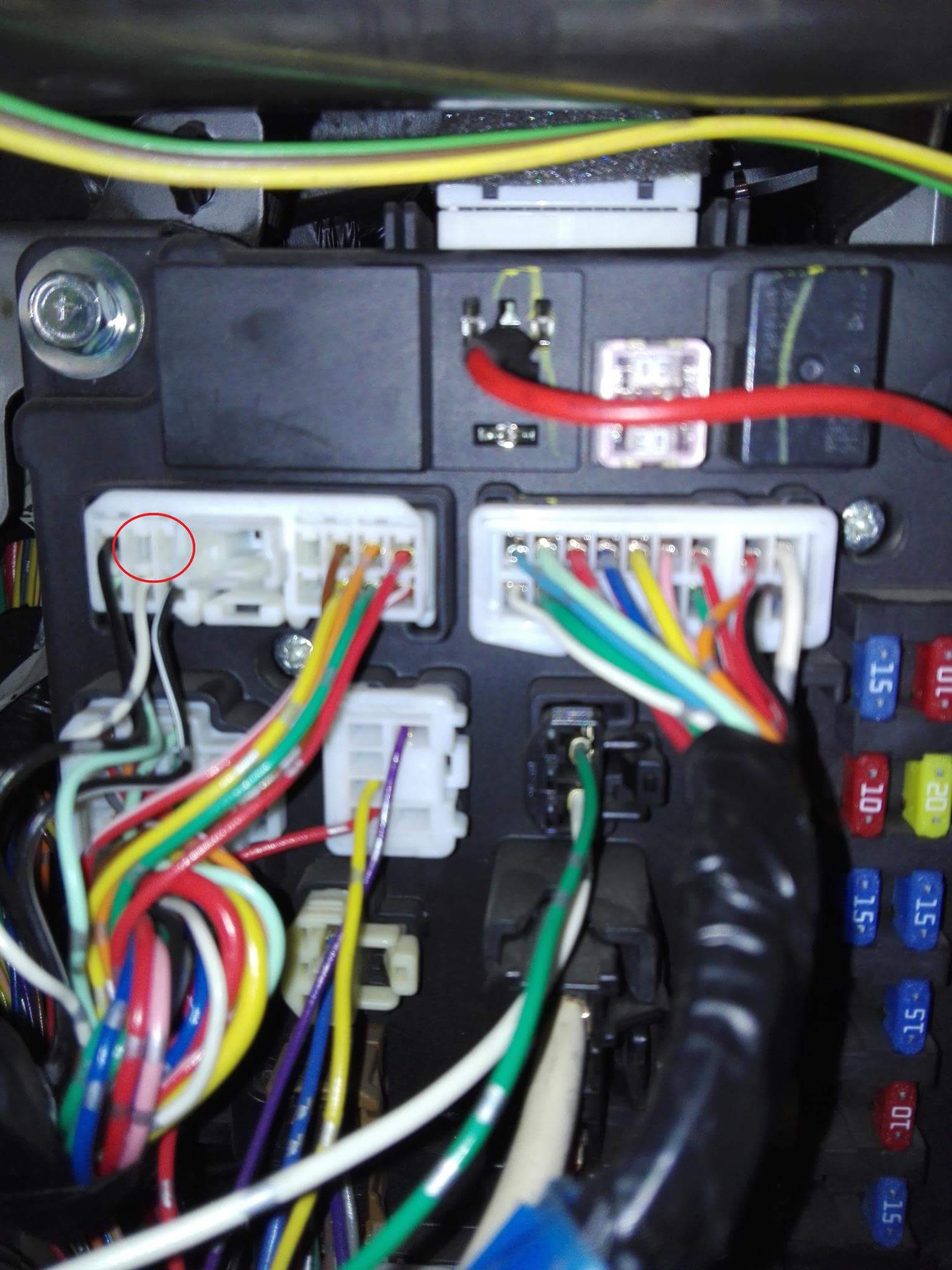

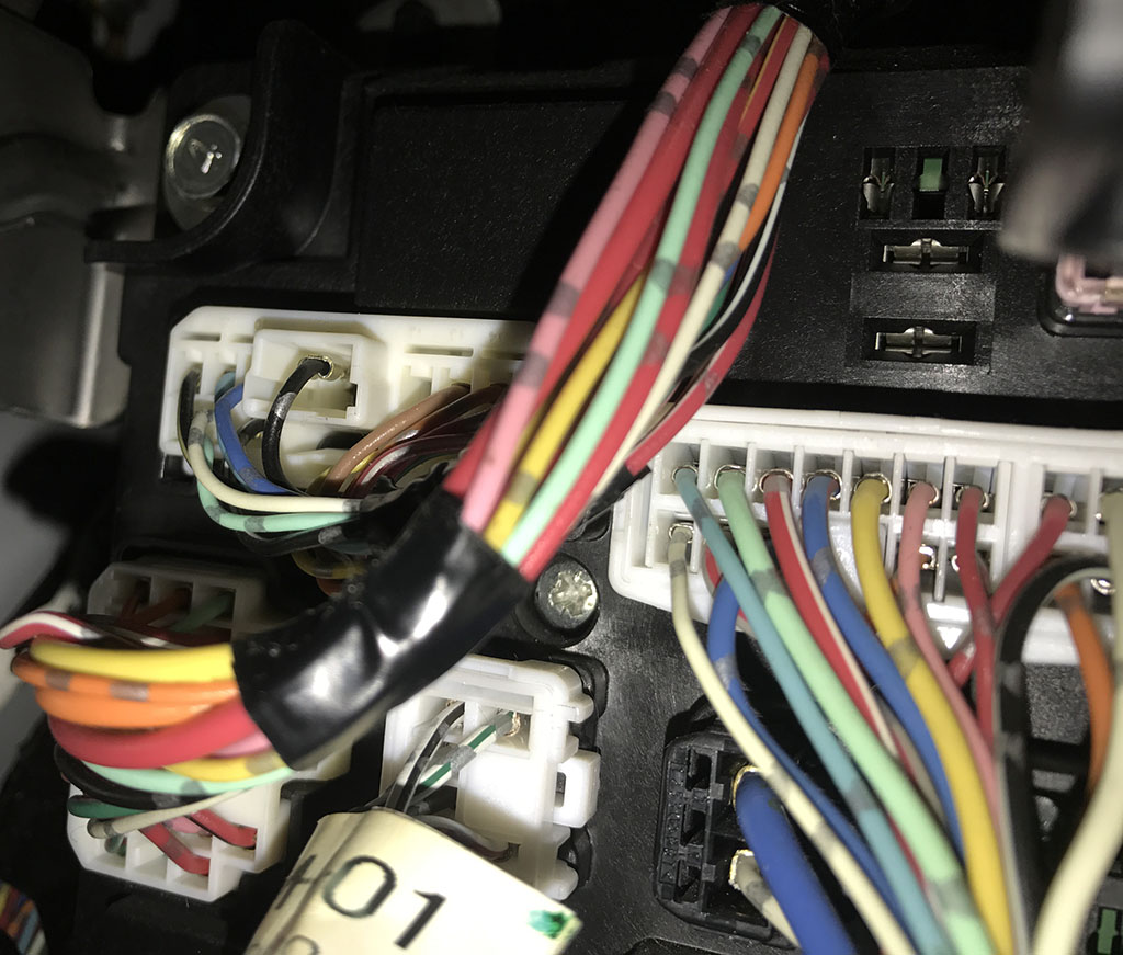

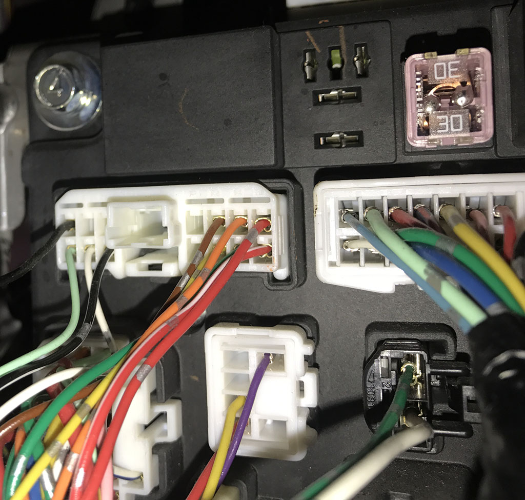

According to Etacs forum some early Lancers dont have the relays in the ETACS module which allows them to fold. It is a massive job to get them working if these relays are missing. You also need different switch for the mirrors. I wanted to do this on the wifes my09 vrx. Ill try and find the link to show you.
MY11 Evo X MR (2011-Current)
MY20 Asx GSR (2023-Current)
adamhumphrey
Posts: 481
Re: Folding Electric Mirrors
Postby adamhumphrey » Sun Apr 16, 2017 9:41 am
I went out and took some photos to show you differences lucky I have an My11 Evo x and My09 VRX to compare too..
What I found from website mentions these two wires as control wires for the mirrors.
VRX my09
Evo X my11
Hope this sheds some light for you.
