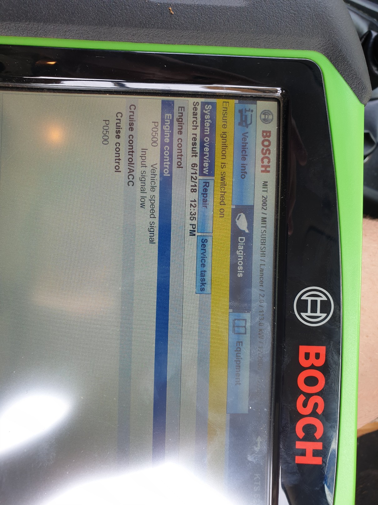

As you've read I have a 2009 Lancer. Recently the check engine light has come on and cruise control has stopped working. The mechanics at my work (Army boys) plugged in their OBD tool and it displayed the P0500 fault along with a cruise control fault. I've attached the picture. The symptoms I have match the issues expected of a VSS although not sure the engine shutting off while driving is one of them.
I'd like to replace the VSS myself if possible but am having trouble finding it in the engine bay and also the correct part online. Any help would be appreciated.

shoot me a PM with your VIN number and I'll track down a part number for you from an EPC, and lancerdarryl's link is to the workshop manual on how to find the part and get it out etc.
