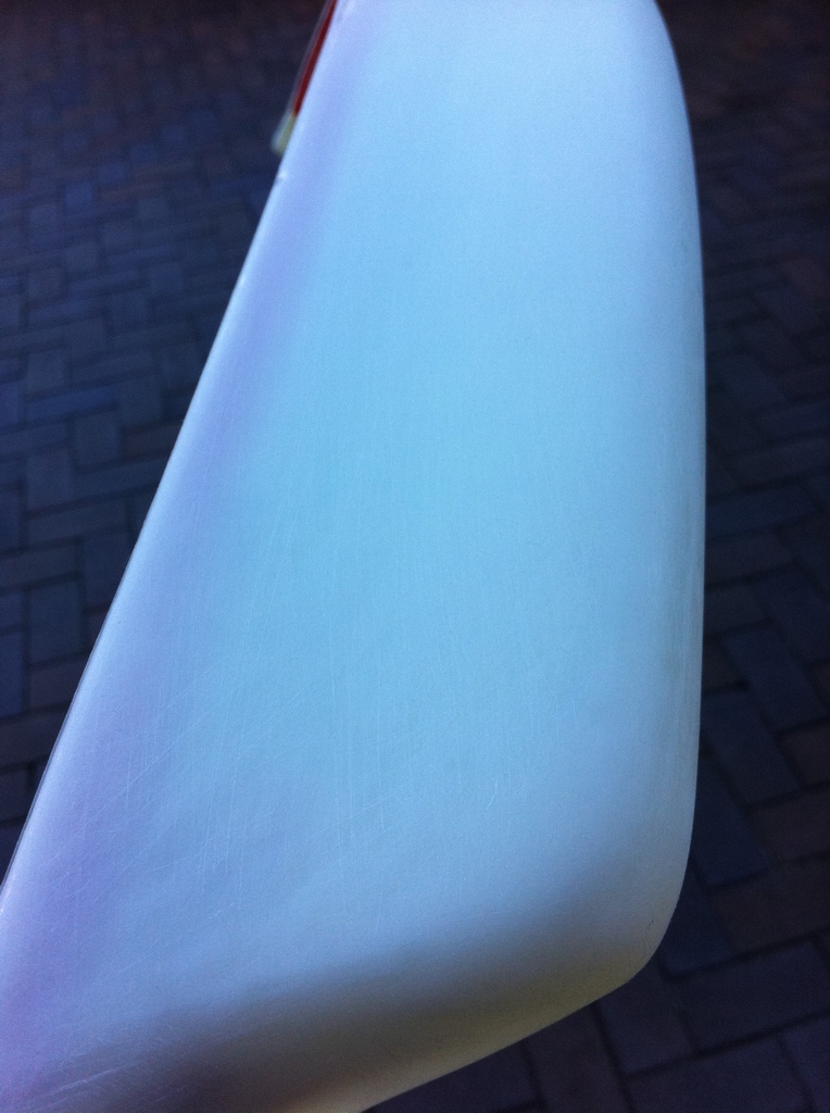

1.
Sand your airdams with 200grit so that it is no longer smooth, this is so the primer has something to latch on to. Should look along the lines of this:
2.
Now that you have that, sand it down dry (without water) with your 800 grit just to get rid of any harsh scratches from the 200 paper so ensure a smooth finish. Wipe it down with your wax and grease/meth spirits to remove any dust/debris etc. Should look like this:
3.
Lay down 2-3 layers of even primer, remember to do lighter sprays as you dont want it to run. Comes up like this:
4.
Today I was using a cheap electric spray gun ( can be had for about $100 at autobarn or the like). Mix your paint to thinners 50/50. Lay down even coats until you get the desired colour finish, I ended up doing 4 or 5 thinner coats:
5.
Get your clear coat and spray down as many layers as possible, I did about 7 or 8 here, this is because once it is dry you will want to wet sand it down and then polish it up to a shiny finish - gives the best results IMO.
Quick colour match shot.
There is still a bit of work to be done, going to wet sand it down with 1500 grit to make sure the area is even, I will explain my method for this when I post up. This will be followed by a polish and then later a fitment how to.
If at any point you make any mistakes, runs etc just let the paint dry, and do a light sand to remove and blemish and continue.
IN REGARDS TO THE BODYKITS KINGDOM PRODUCT IT BECAME APPARENT THAT THERE ARE DEFFINITE IMPERFECTIONS FROM THE MANUFACTURING PROCESS. THERE WERE GAUGES/DEEP SCRATCHES THAT COULD BE FILLED IN WITH A PUTTY BUT WILL BECOME BARELY NOTICEABLE WITHIN THE FINAL PRODUCT.

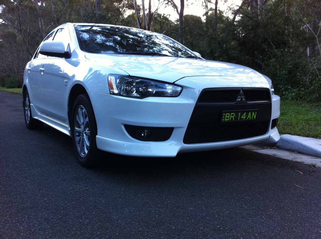

Postby BR14AN » Wed Jun 27, 2012 3:48 pm
Final steps, get a bucket of soapy water.
Sand with 800, then 1200 and then 2000 grit. It will come up like this:
Then get out your polisher and do a couple coats:
Finished product:
Fitment was pretty good except the ends on the inside has quite a bit of gap, planning to get some white silicon and fix that up.
BR14AN
Posts: 650
Joined: Thu Jan 21, 2010 10:53 pm
Location: Cherrybrook, NSW
Postby BR14AN » Wed Jun 27, 2012 4:37 pm
Just noticed that these arent actually identical to the oem vrx air dams, they are shorter in the sense that they dont come as far in across the bumper in the center, Thus im assuming aftermarket lips will not fit great.
